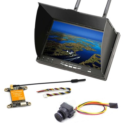

My Inspire has a fpv camera mounted in the nose cone with a transmitter and 2s lipo stuck to the tail end. On the ground I have an inexpensive flysky rcvr/monitor. Haven’t tried it in the air yet as I am just finishing fixing the broken transmitter. Cheap and seems to work.

The way my I1 is set up the fpv system is completely seperate from the I1. It uses it’s own 2s lipo stuck to the drone with velcro and sends it’s signal to a screen with a built in diversity rcvr or any fpv goggles as well. The parts are commonly found on ebay. Some of them are all in one units now but mine is seperate components. Here is a link to a kit similar to mine.
