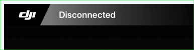

Yes. In addition, you can scan the area for WiFi interference via the Go App, like this:
This should tell you that at the very least the RC has basic functionality and the RF circuitry is working.
When disconnected from the RC, the Go App will show that it is "Disconnected." Like this:

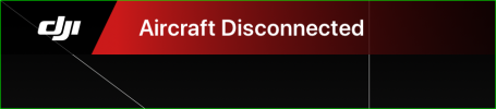

Once connected to the RC, the gray area turns red and says "Aircraft Disconnected."

I already explained that the gray "Disconnect" at the top shows that you're not connected. We want to see a red "Aircraft Disconnected." Any other photos are moot.
