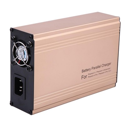

Buy a parrellel charger, I can fly a P4/P4 RTK all day with 5 batteries, a 2KVA inverter in my truck and a 3-way parallel charger.
I clocked up over 40 hours in the air last week using this setup. You need to make sure your vehicle's electrics are up to the task, install heavy cable to the inverter directly from the battery (with fuse) keep the motor running, or buy a generator. either works fine.

We do this with an Inspire2. It takes 4 chargers and 6 battery sets (so one set can be cooling before charging). You’ll never do this with a single car charger. You’ll need a generator or a large inverter. Be sure to leave your car idling if you use an inverter. A Prius is ideal!
