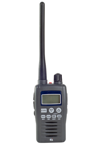

This is what I use:
It runs on AA's. Rechargeable units go bad quickly especially if you abuse the batteries by not using them and not maintaining them. I learned the expensive way. Works great and since you're not transmitting the batteries last. Throw in a fresh set when needed......
Transmit in an emergency...
The band coverage is 65-108mhz and 136-174 so I don't think it covers airport bands which was my point kinda. That is what I am trying to find out, IDC about much else other than will it tune into those bands. I am not super proficient with radios so it may sound like im answering my own question but im not sure. Thank You
