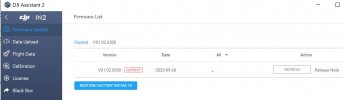

I'm having a problem with update .0500. The Go app just always shows critically low even though they're charged. Upon checking the battery voltage, it just shows N/A for both. Not detecting the batteries? Tried with 8 batteries, same problem. Any advice pls?

I'd probably try DJI Asst and perform a Refresh and reinstall the FW vs performing through DJIGo4 app.

Thanks. I've just installed that in my laptop. Need to buy usb to usb cable then try later. Hopefully I can revert the update done to the batteries using the Assist.
Upon checking Assist 2, it seems v.0500 is the only version available. I can only Refresh the update but could not downgrade. Here's an image.

I don't think you can back grade... I think I recall in FW notes it indicated stepping back was not possible. Others may know how to back door a down grade.
I would try to refresh the .500 FW. That may correct it... perform it 1 or 2 times.

Thank you. I tried refreshing and the error stopped. Hopefully there'll be no more errors come time to fly in the field

Before you assume it's all good to go, throw a set of Full Charged batteries in, and fly it around to draw all the way to verify both Low & Critical behavior triggers. I normally test full speed, full acceleration & braking, all RC flight modes, full accent / decent tests, all normal navigational moves, and a quick autonomous grid above my home to verify it can correctly process prior to being on a work site. Always take note of the issues others mention after a FW upgrade and verify or test them on your own craft to determine if they exist. Don't assume FW will be consistent on each craft, another unexplainable... it can exhibit a different behavior.
Sometimes it requires DJI Asst over RC / Tablet and pushing a few Flashes to Refresh to get FW all written.
I don't quite understand why, but it has corrected several FW issues over the years for many.
