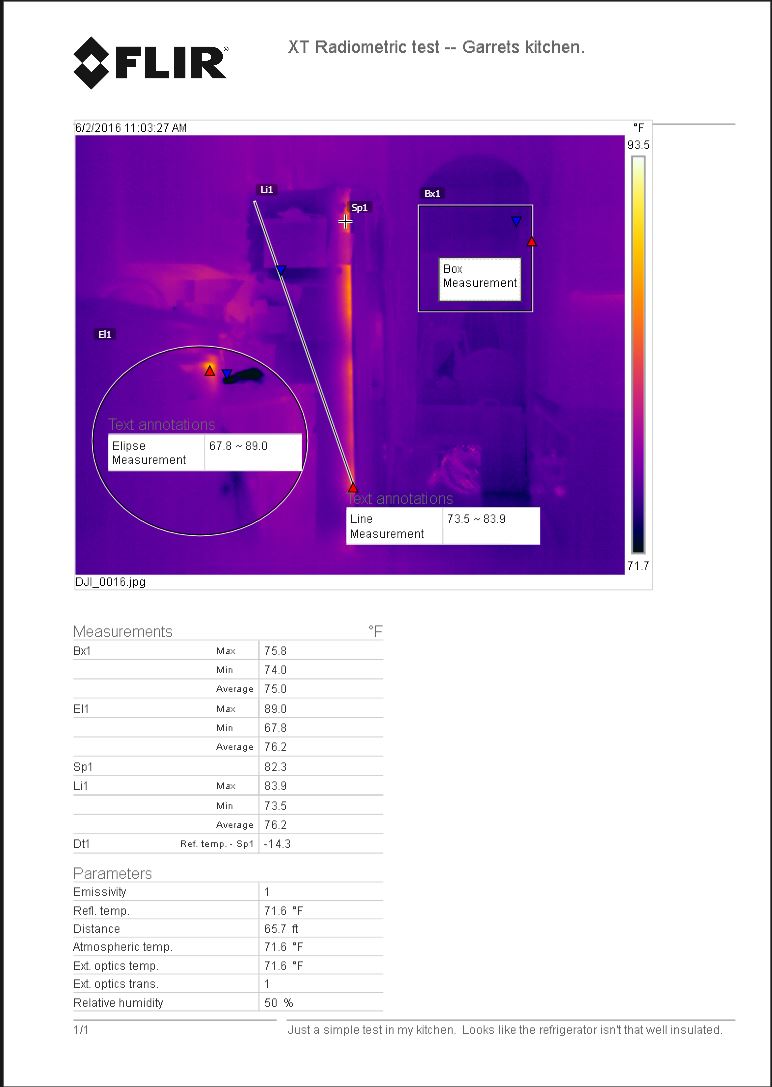

Standard DJI Zenmuse XT now produces fully radiometric images
So does this mean I can now take multispectral images using something like DroneDeploy and get true NIR data? I'm wondering if this now means I can use the XT for NDVI mapping instead of a modified X3.

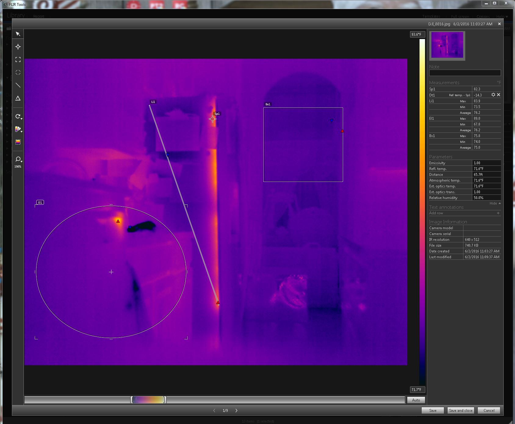

Hey, first post. But I laughed at the fridge. The fridge magnet seal is going to be warm lol. It has a small heat strip to prevent ice from forming and locking you out from your sweet sweet ice cream!
EDIT : My bad! Selected the image option of Radiometric JPEg instead of JPEG (DJI Go app) and it worked like a charm..
hi kxkraze. I have a zenmuse XT standard with the latest firmware but my images are non radiometric..ie the flir tools s/w sees them but does not show tha temperature info etc. What am i doing wrng here? please help.
