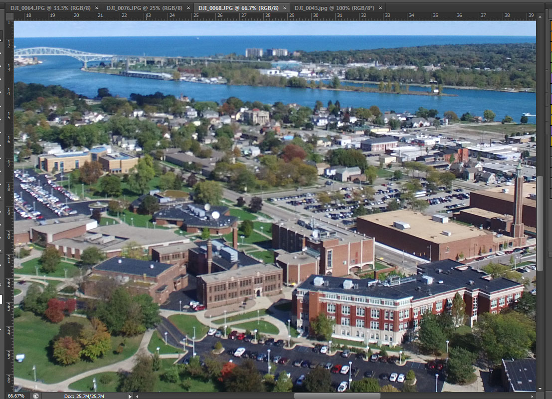

Is there any way to focus the X3 camera? I recently purchased a drone from a friend and the X3 is out of focus. He only flew it a couple times and never crashed it, so it is in mint condition. He said he did not have a focus issue but I am not sure if he knows for sure.
I could not find a focus function and read that the focus is fixed. I even tried removing the filter and still it is soft. I compared it to the Hero 3+ from my phantom 2 and the gopro is sharper. Any help would be great.
Do I send the camera into DJI to have it worked on?
I attached the image but to see the blur you have to zoom in a bit. It is obvious when you zoom to 66% in Photoshop.
Should I send it into DJI to have it looked at?

Infamous "DJI Tilted Sensor." Compare sharper right side vs. left side. Bad camera, and not that uncommon for DJI products.

The X3 has a screw in off the shelf lens assy inside it...
Do a search here under my user name and you will find some background (go back over a year ago)
I have four X3's and three of them have the lens swapped with different ones... (NDVI,NIR,72* FOV)
But yes... you have to set the focus by screwing the lens body gently all the way in, then back off till it's focused.
Took a fair bit of trial and error to set each one up at infinity focus... take long distance pic... look at blow up... repeat
DJI locks it down with glue... The replacements I used have a rubber o-ring to keep it in place...
Takes a hefty twist with a lens pliers to break a stock one loose... feels like your breaking it...
In theory... your X3 could be fixed... up to you... (break loose, clean up, reset and reglue)
