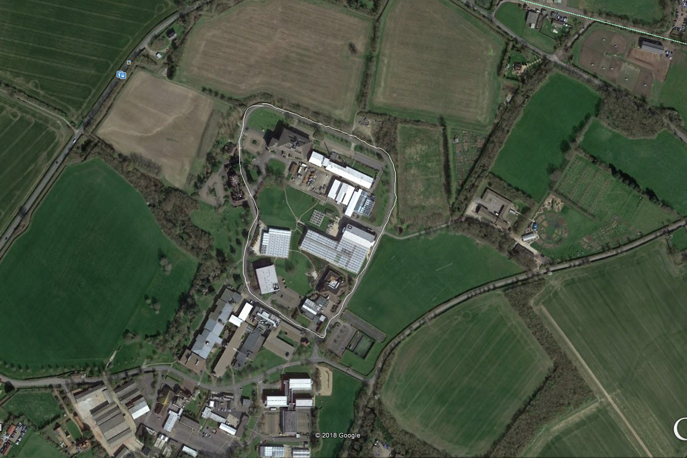

Hi Nick. Here you go. The white line is the ring road. The fields outside of it are part of the site, then public main roads. cheers

Thanks. Yes I use Pythagoras and have made myself a laminate card I can keep on my person for reference. Next question , would a company site be classed as a congested area ? Ie settlement . I would assume if a team of colleagues went outside to play cricket on one of the fields then one would still class it the risk within the 50m , being less than 1000 people ? What if the site has 1000 people or more but never outside at any one time ? I’m assuming building protection mitigates risk further so still classed under the 50m rule ? Thanks.
The bottom line here rich146 is that without a PfCO you are not permitted to fly your aircraft within 150m of any built-up area and you are not permitted to fly within 50m of any structures or persons that are not fully complicit with the flight.
Would a company site ... Yes, the buildings within your google map make up a congested area, with the exception of a couple of isolated structures.
.. if a team of colleagues went outside to play cricket...
The field to the right of the warehousing is marked up for football and there is evidence of a cricket pitch too, so that field is also part of the congested area, this field also conjoins with the small complex of buildings to the right again to further extend the dreaded congested area. So No, the 50m rule does not apply, the 150m rule remains.
What if the site has 1000 people... There are additional rules that govern flight near gatherings of 1000+ people. Basically everyone including PfCOs have to remain at least 150m away from such gatherings unless they have an OSC like me ;) ...and NEVER fly over such events. This rule is really aimed at open air events such as galas, concerts & parades etc. but the LAW isn't that specific which means it effectively applies to all organised gatherings of 1000+ people. And I'm pretty sure that a fire drill would be considered to be an organised gathering. (think: marked assembly points, fire-marshals, drills, written notices etc. ...all very organised!)
Your assumption about a building mitigating risk is reasonably valid but even then could easily become invalid without first finding out where the emergency assembly points are which are used in case of bomb-scare/fire/ fire-drill etc.
As a non-PfCO you have to ask yourself how many buildings you can find that may have 1000+ people inside and are not within a congested area? Even an out-of-town high school would be classed as a congested area.
