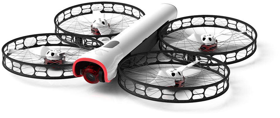

Not sure what's with the prop guards, are the stabilized with many thin wires?
Hey there - I'm a co-founder at Vantage and did the design on those prop guards. The prop guards are in fact stabilized with many thin wires as you say taddessi - 0.012" tempered high carbon steel wire to be precise. They form what is known as a tensegrity structure - basically a form in which all elements are primarily in tension or compression. As you might imagine, materials can be used most efficiently in this form, creating the strongest and most resilient structure for the lightest weight. A bike wheel is a prime example of these structures in use.

The P3 can work for people who don't mind the lack of portability and safety issues. Specifically for the follow me shots, we found open blades on the P3 to be a challenge - we didn't feel comfortable having a product that could severely injure someone flying without a pilot.

Our experience with the blade guards is that they are fine for protecting the blades, but nearly useless for protecting people. Here's a good example ->
A minus from me for this statement just because I dont believe you would take care if you could earn money with it. Sorry just doesnt sound honest so what should I think of the rest?
