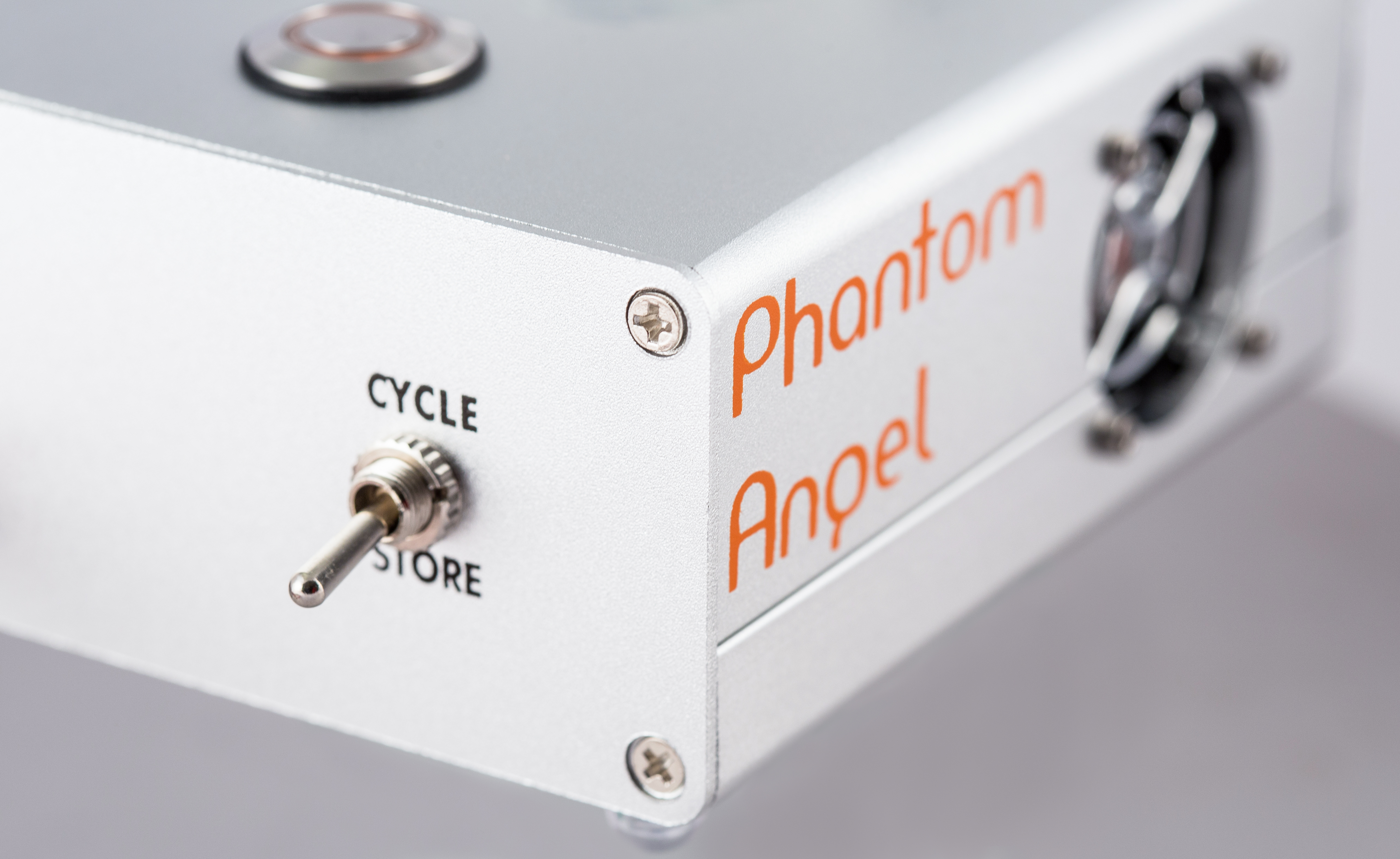

You can buy devices like this or make your own. A lot of people have built discharges using auto light bulbs.
Aliexpress.com : Buy Rapid Discharging Discharger Set For DJI Phantom 2 3 Inspire 1 3S 4S 6S Battery from Reliable battery pack for iphone suppliers on BIKE IS HOT | Alibaba Group
Also, use of a device like this is at your own risk and never leave a LiPo unattended while discharging (or charging for that matter). It's safest to discharge in a fireproof container like an old ammo can from a military surplus store.
