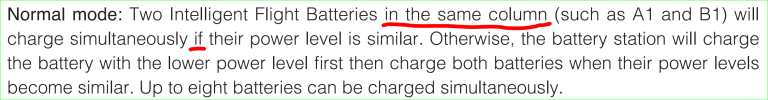

Well, well, well...look what I found. DJI directly conflicts its own claims right there in the manual within the span of a single paragraph!! Chinenglish.
The last sentence directly conflicts with the first sentence. Take my word for it. This charger does NOT charge 8 batteries at once or "simultaneously." You can INSERT 8 batteries, but only TWO will charge "simultaneously" IF they are IN THE SAME COLUMN. The last sentence of the above screenshot should read, "Up to 8 batteries can be charged SEQUENTIALLY." Not "simultaneously." Chinenglish.
I see where a layman or housewife might be fooled by the conflicting claims within a single paragraph, but we are neither. We are professionals. We are technophiles. The direct conflict sticks out like a sore thumb to me.
It also states in the instruction manual that in normal mode it will SIMULTANEOUSLY charge 8 once voltages are matched between banks.
Well...that's a stretch. Read closely.
The last word of the above paragraph should be "sequentially." 8 batteries most certainly do NOT charge "simultaneously" or "all at once and equally."

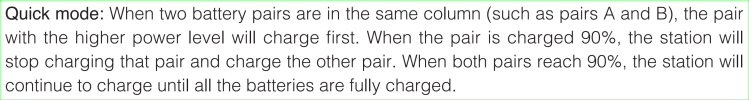

AND here's "Quick mode"...
This can either mean that columns C and D don't charge at all until A and B are fully charged.
OR...that C and D start charging once A and B reach 90%. Once A, B, C and D ALL reach 90%, THEN they all finish the remaining 10% equally.
Either way, this is NOT "charging 8 batteries simultaneously." The math simply doesn't work out. No U.S. receptacle can provide enough current to charge 8 batteries simultaneously (assuming 180watt charge per battery).
I invite you to challenge or refute anything I have purported here.
