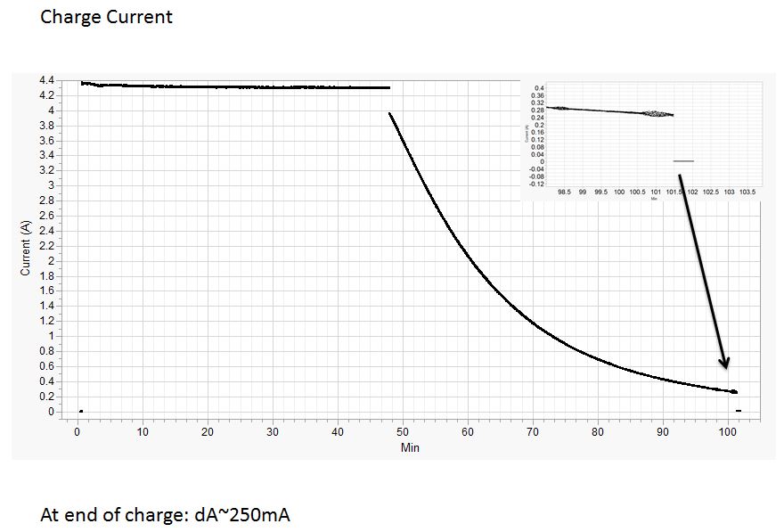

This is possible if you're lucky enough and the charging current going into each battery is maintained at approx. 6 A max. The power supply must be a true CC/CV (as mentioned by Kilrah), and indeed all DJI chargers are. If not, the battery will ask for more juice at some stage of charging (with drastic peak at about 75% charge) and - if delivered - will shut off sensing approx. 8 A current.
The Chinese triple charge boards like he probably has typically have high wattage resistors in series with each battery to serve as (very) crude limiters. That works pretty OK in normal conditions and as long as he always uses it even for one battery, connecting a battery directly to the power supply would be where it gets ugly.
Here is the current profile for the standard DJI switching PSU on a 48...
Correct and confirmed by my findings as well. Aside DJI's AC/DC chargers, I've been experimenting a lot with DC/DC step-up converters trying to find sufficient solution for multiple battery field charger. Some relatively cheap open circuit boards are available on ebay, claiming CC/CV capability. Not really, as I've discovered quickly ... Although setting the charging voltage is simple and reliable enough, the current limiters aren't up the task and must be tuned carefully for starting charging level. Smart DJI battery will demand more juice during charging process and - if supplied with - will eventually shut off. These converters provide relatively flat current for about 45 minutes, then suddenly deliver demanded peak for about 5 min and finally the curvature goes quickly down as usual to 250mA at the end, give or take. This current peak is where smart battery must determine if it's acceptable or too high...
