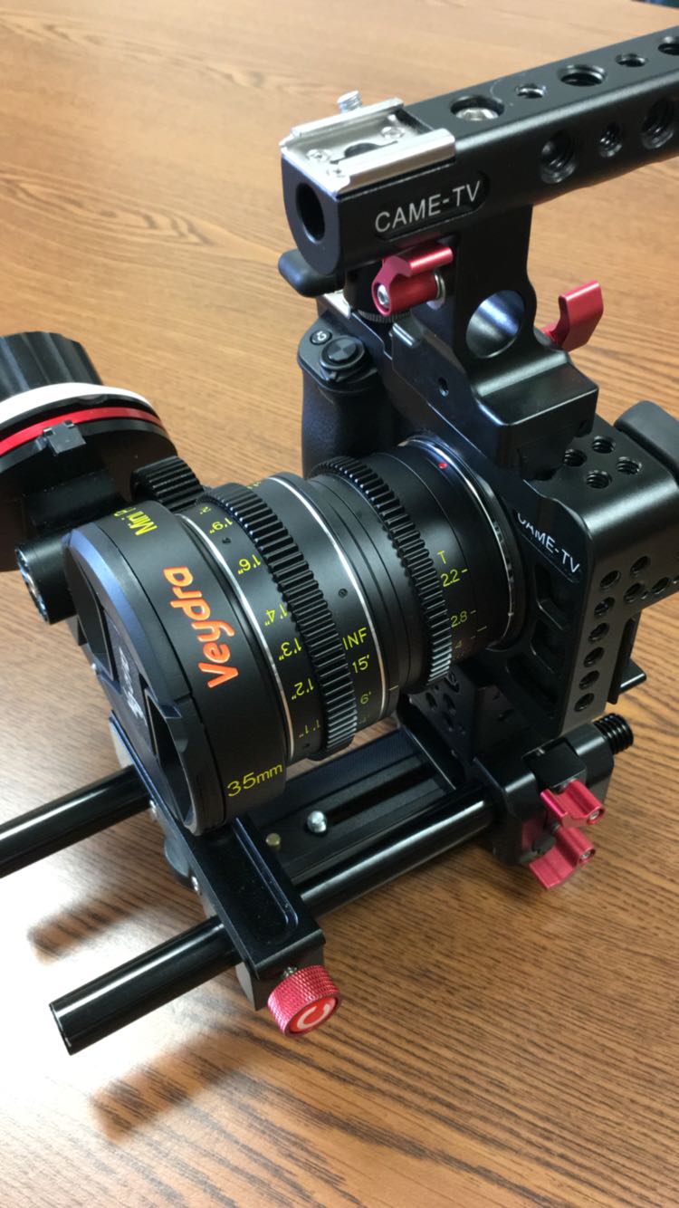

If you went to a business with a toy looking camera and asked for $3000 to shoot a tv commercial you would be laughed at. What you forget about is most tv ads are in SD only and even if presented in HD, they are converted for tv. There is no 4k on television. I don't see any soft video in my mark 3 but the DR has its limitations. It is also meant to be sharpened in post. The truth is we have been shooting HD for 10 years and its only the last 6 months there is HD content in this country. If I went with the Sony, I would have to pimp it out with matt box and rails etc to give the clients the impression it was a pro cam.

The mark 3 is also small, but it is twice the size of the Sony. You are right. if you are not pro then you can use an iPhone if you like. The results I need are in my pocket. Thats the important thing. The results you get don't matter. The results I get go on television and I get paid well for it. Thats the bottom line. Im not saying the Sony isn't better, Im just saying it looks like a toy to clients.
