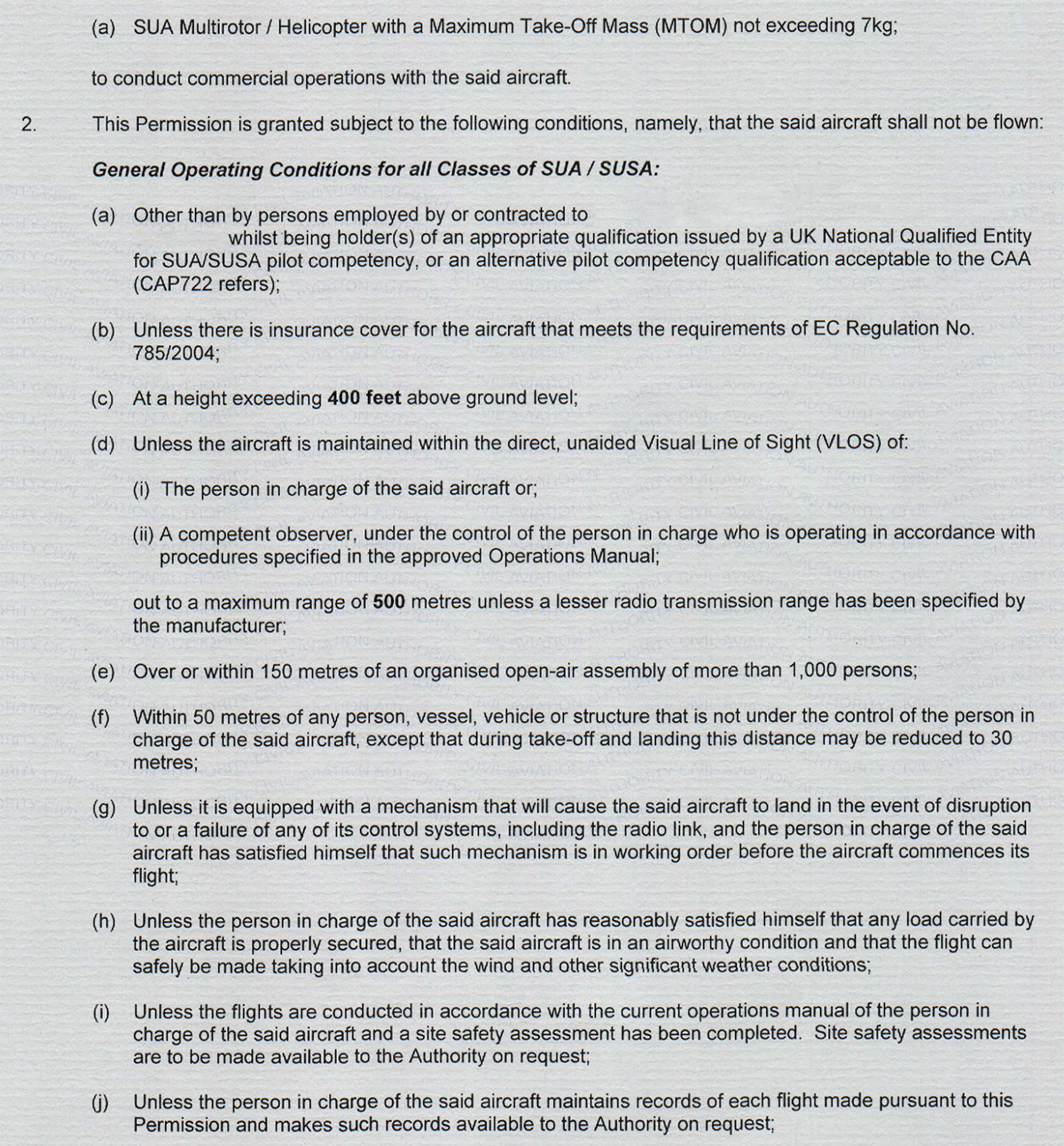

I've just scoured my PfCO (issued last March) and as NickU mentioned, the CAA have relaxed their approach.
Reading my PfCO, as long as I am not trespassing and there are no bylaws in place (therein lies another conversation) or have the landowners permission, and assuming all MSD's are maintained (including the 150m of an open area assembly etc.) once airborne and I'm pretty clear to navigate the airway.
I'm surprised the CAA have removed the 'directly overhead' references to highways and property not under the pilots control though.

Hi heliraptor.
It seems that the CAA are Tweaking the wording of the PfCO (PFAW as was) quite regularly.
Please can you post your PfCO wording so we can compare it to our (older) permissions?
Sure, valid form last March so soon to be renewed, but it varies quite bit from the previous year
Note: Just the under 7kg section uploaded as that's all I fly.
full
Reactions: MrTVR

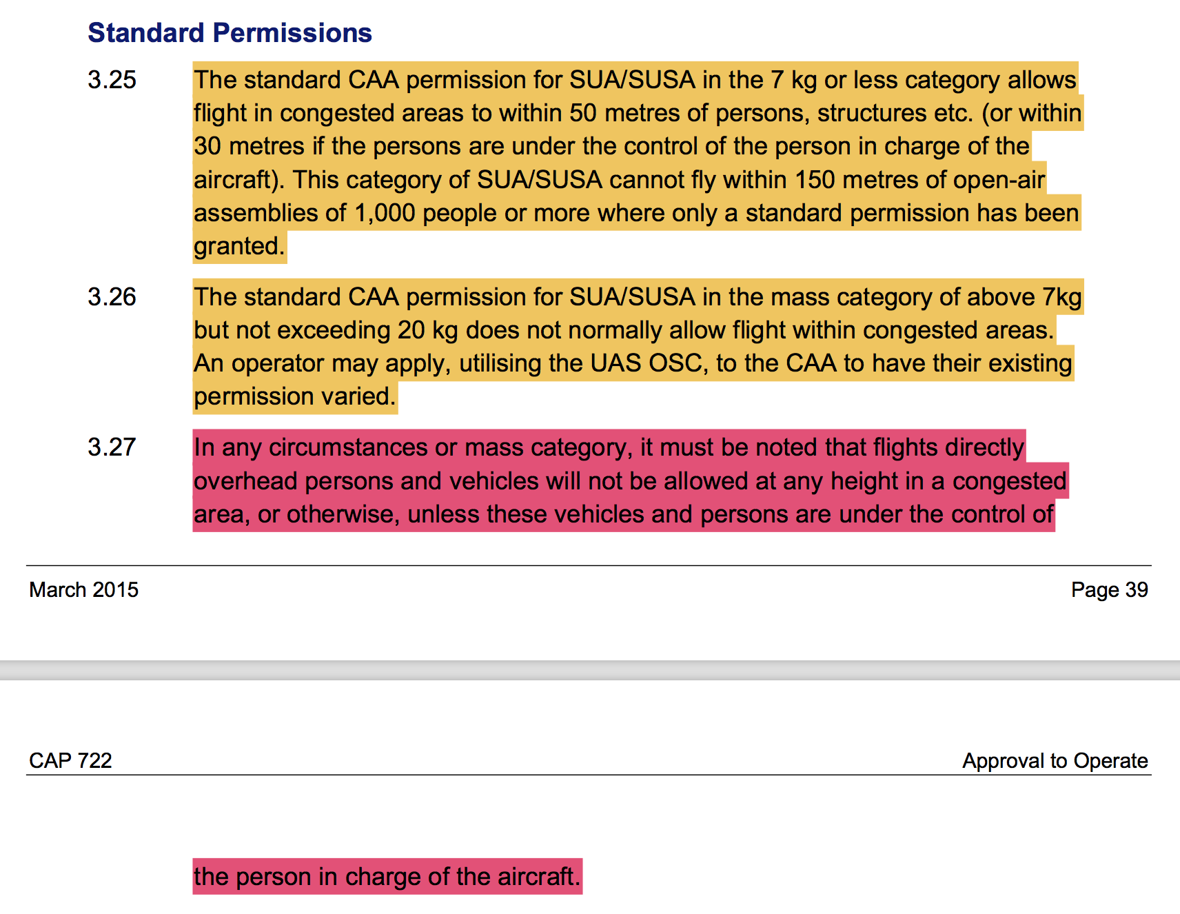

Just checking and regardless of what it says on your PfCO (mine copied above), CAP722 Section 3, Chapter 3.27 clearly states...
'In any circumstances or mass category, it must be noted that flights directly overhead persons and vehicles will not be allowed at any height in a congested area, or otherwise, unless these vehicles and persons are under the control of the person in charge of the aircraft"
Is there "or otherwise" comment a catch all meaning everywhere else?
Reactions: MarkLincs
PfCO overides anything else since it is a specific (personal) permission granted to you by the CAA.
Otherwise a close proximity OSC permission would be overridden by what it says in the ANO.
