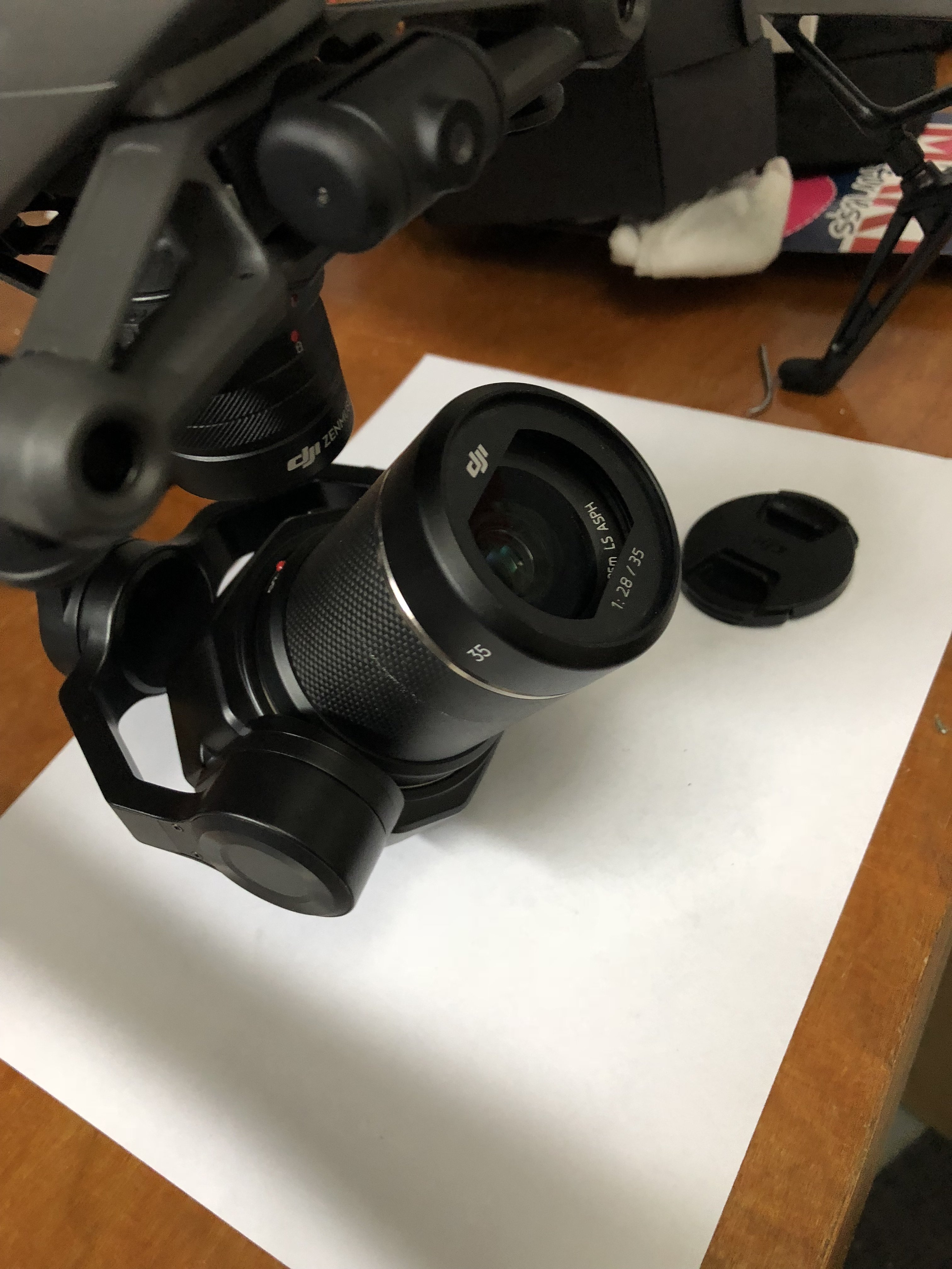

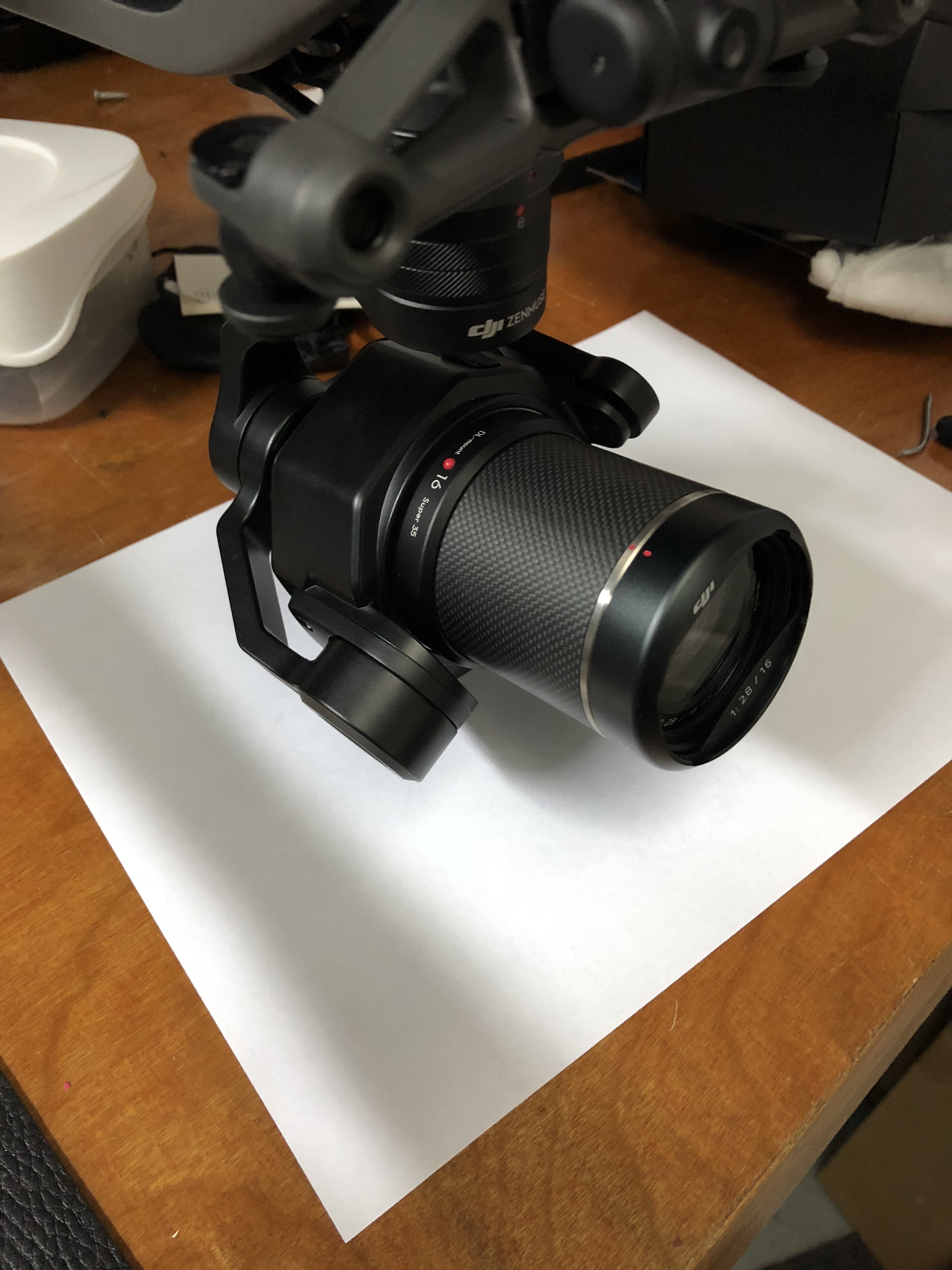

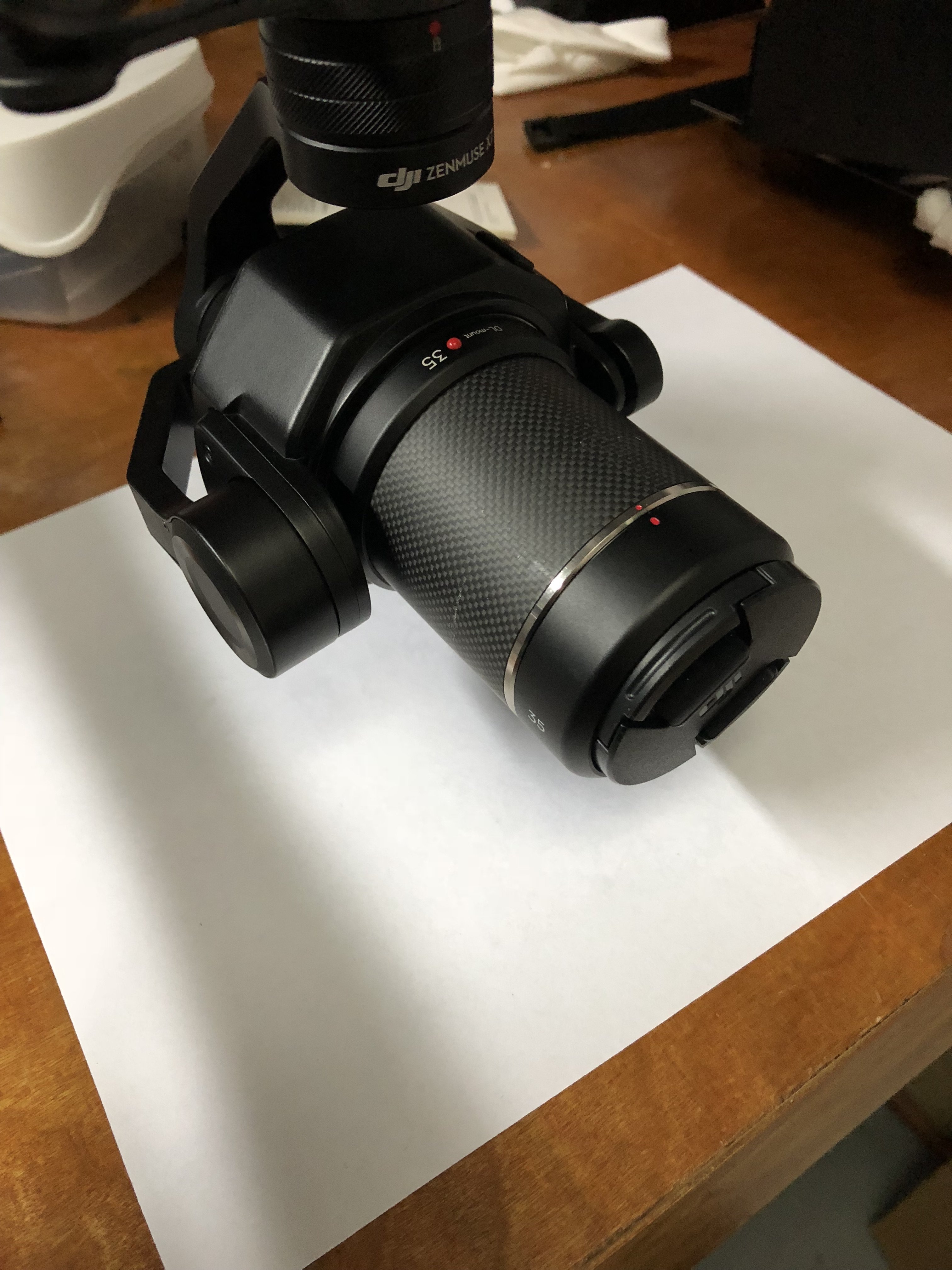

I have purchased 2 lenses, the 16 and the 35. The 16 balances well, but the 35, like other folks, is back heavy. Several times, when starting up, I get a gimbal overload warning, so I want to deal with it. I am working on a workaround with blue tack, but completely around the lens. I wonder if the solution of SanCap will result in a bottom heavy problem for camera roll adjustment by the gimbal?
If you keep them clean you can put multiple ND filters on the front to balance. You could even remove the glass from a UV filter and wrap Gaff tape around the empty ring until it balances perfectly. They you also have a stealth lens hood......

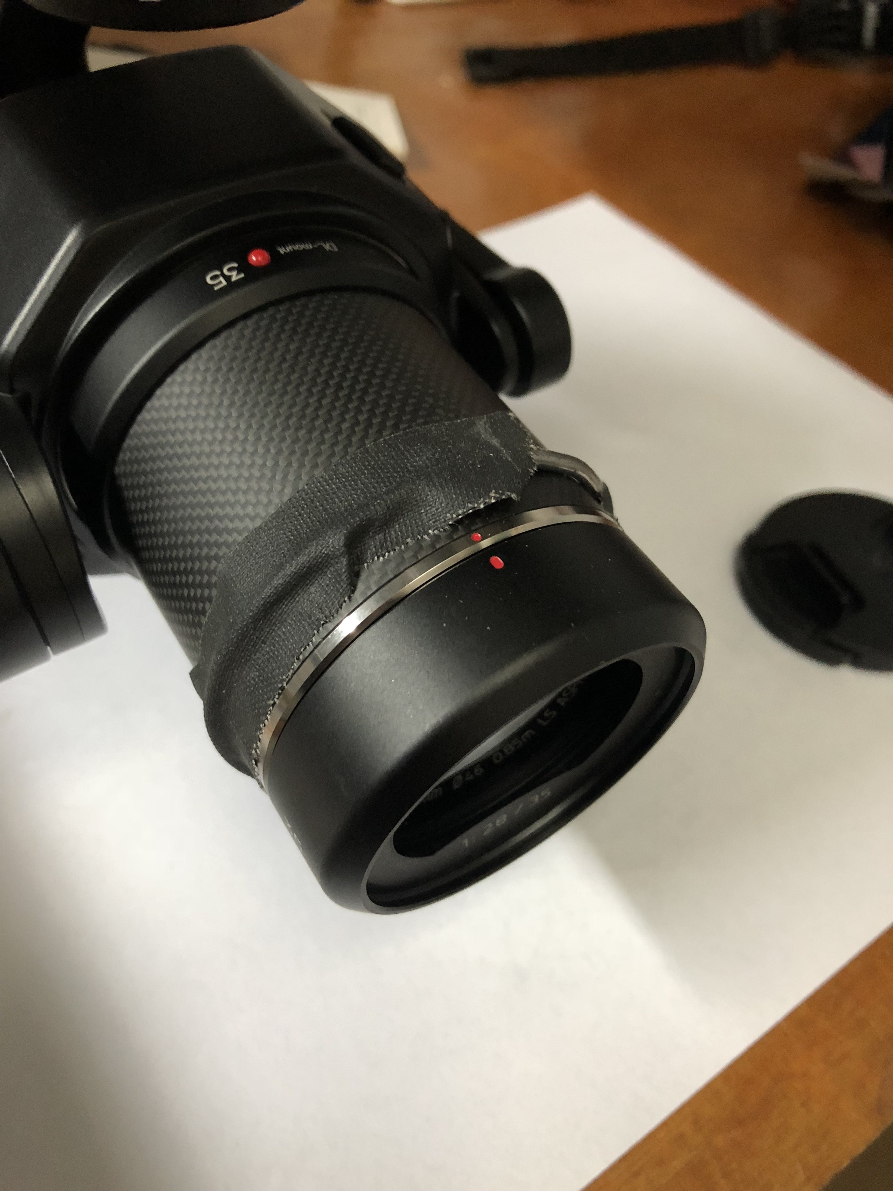

I balanced the 35 with gaffer's tape holding a ring of solder around the outside, but then I began getting gimbal overload when I start up. Just for a second or so, but not happy about that. Seems like a lose - lose.
