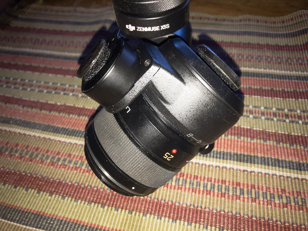

I have been flying the LEICA DG SUMMILUX 25/F1.4 on the X5S. Very sharp except at the corners and has a wonderful look to the images. You can read about the lens elsewhere.
Works, but aperture in Manual Mode must be changed using the camera control wheel on the remote as the on-screen menus will not change aperture. Works fine in AF but have not yet been able to get it to calibrate for MF.
I used a 42g button of lead on the rear (for pitch balance) and a US quarter on the side of the pitching motor (for roll balance). No flight issues.
Where do you recommend that I purchase the lead buttons/ velcro from?
Hey Ralph question. I flew the inspire 2 with the 25mm panasonic summilux 1.4 for the first time and i had a few questions.
  1. If you can't focus using the screen then how else are you supposed to manually focus. (the lens calibration wasn't working for me)
  2. Have you ever had trouble auto foucsing because it seems to be very difficult on my end to get the auto focus right.
