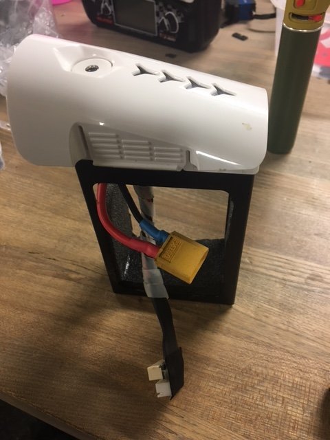

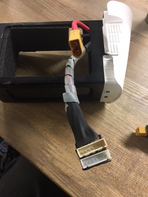

I've done it .
I can connect One 6S Batterie or even TWO ( In parrallel ) with the balance plug for telemetry in the app .
I've made also a cabe so i can Charge and balacce my inspire baterries on my Junsi Charger ( better balancing)
When I store my batterie I Charge/discharge them on storage voltage en leave the balance plug unplugged. If you let them plugged in they are for shure going dead if you let them sleep too long.
(Sorry for my english, I'm from Belgium )

I noticed when I took apart battery from inspire 1 that there is some sensor connected to the board and is on one of the cells. I figured it was a heat censor. How do you manage that in this mod? Or doesn't it require a heat readings to work?
You can longer the wires. And fix them every time on the battery, but I don't use it and let it as it is.
You can longer the wires. But I did not. The temp sensor prevents Recharching in original housing when battery is to hot. I measure it with IR thermometer after the flight. And in flight it becomes rare they are to hot because now the cells take enough wind in flight. The original battery is packed very cached in the bird, so they can get very hot.

Can you be more specific on where to solder the xt60 plug / wires?
Can you show the details about the wiring to the board.

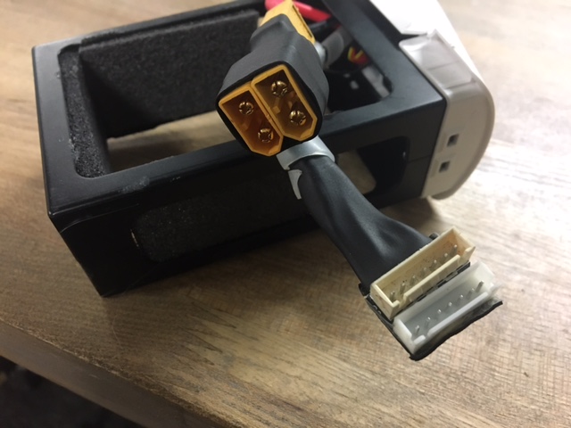

I use this mod because now I can use any lipo. They are much cheaper. And I can also see the voltage of each cell in the app When I use two 5000 mah lipos on each side of the bird i that way I have 10K amps. When you use lightweight lipos the bird is only a little bit heavier and you gain flighttime
Reactions: red_raven
The balance connectors are also in parallel. So when you use 2 units 6S2P lipos it's like flying with ONE 6S4P lipo.
