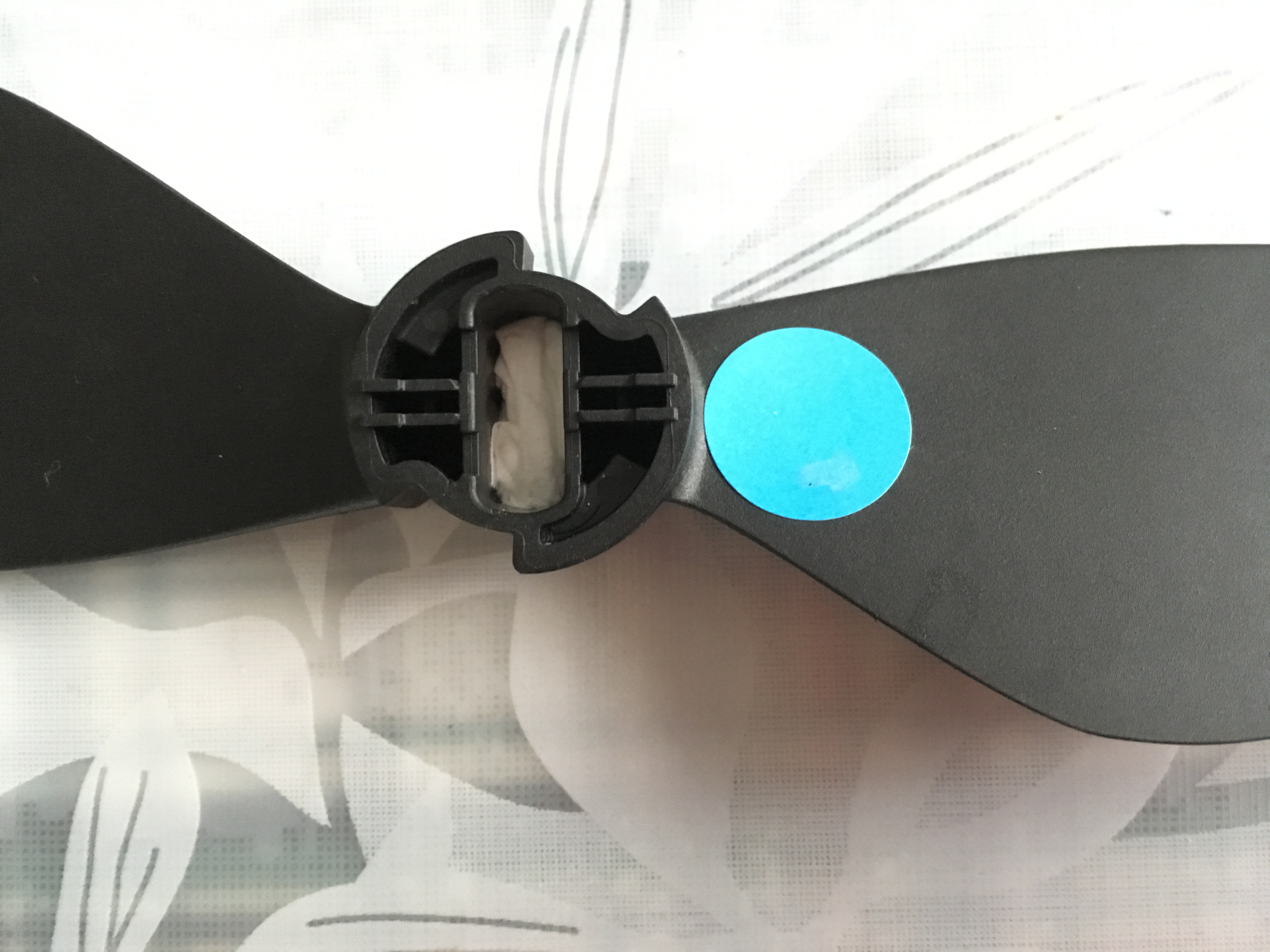

My I2 arrived today and in the build phase I mounted the props to check how to use the fast mounts.
I found after fitting the "red" props that if i spun the blades around the red ones made a rattling sound. After ages of investigating where the noise was coming from i found that when the quick lock was closed on the prop there was till movement in the blade. (side to side)
Called DJI and no help there...
In the end i found that by inserting a small amount of tissue paper in the depression between the blade and the raised mounting point the noise went away. This was only 2 ply tissue so only a very small gap... I the found some single sided foam tape and inserted in the place the tissue paper was so i don't have to worry loosing the paper in flight.
Problem resolved
There was no problems with the white props !!
would advise you check yours as this causes serious miss balance and could damage your motors
Hi Dr jon, can you post an image to show us where exactly you put the tissues?
Thanks so much.

I just noticed my forward red prop had the issue mentioned. I have flown my bird for a little over an hour and the rattling did not cause any noticeable vibration or unusual noise in flight. However on the ground I noticed the slight play (very slight) and when I turned the prop by hand it made the rattling sound... so I put a small piece of foam into the propeller, underneath where the top nub is and it seems to have fixed it. Hopefully DJI can provide a more permanent fix since as others mentioned, this should not be occurring on such an expensive piece of equipment.

By using the spare red mount and swapping props around I've found a combination that does not exhibit the 'rattle' when you spin the props by hand.
Personal choice I know, but I would not fly if I had not been able to eliminate the rattle.

I just hand spun the starboard side rear and i can hear the rattle. port forward seems fine. I'll swap out the mount and report back on the post landing vibration and rattle.
I placed foam under all but one prop now. The other 2 were also exhibiting a slight rattle when I spun them quickly by hand, but not quite as bad as the first one I "fixed." I still notice that the motors do vibrate or wobble a little on shutdown. Everything looks very smooth and perfect until right after I land as the motors slow to a stop...

I just swapped the entire red prop quick release/mount and the rattling is still there. So i decided to try the 3 red props on it. Only 1 of the 4 red prop did not produce a rattle when hand spun, leads me to believe that it either doesnt fit properly, or it is not balanced properly.

You may have a good point as both prop and quick release are both involved in tolerance that is closed when the quick release is rotated. I made my conclusion that even if i changed the quick release for the spare provided it made no difference to which prop made the noise.
My simple fix was simply raising the hight of the blade and the quick release then was under more pressure hence a tighter fit and no noise even if the prop was out of tolerance.
