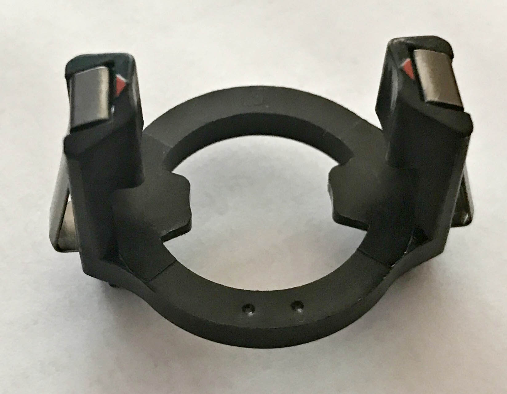

There is another way to fix this rattle problem with the red props. From I can see the major part of the problem lies with the hub, specifically the part that has the metal clips on it. On this part the areas that lock onto the props are not the proper length (off by a millimetre or so). You can take the hub part with the metal clip (a white one) and use it on the red prop. All you do is dab a bit of red paint with a toothpick onto the small white triangles. So let me sumerize, you use the flat silver spring for the red side, the centre of the hub for the red side, BUT use the part with the metal clips that you squeeze in to unlock from the white side. You need a couple of spare sets of prop hubs to do this as you need to use the metal clip part from the white sides.
I'm sure DJI will fix this problem with new red side hubs, but for now this is a fix that works, and I think it's a better way than foam in the prop, or toilet paper for taking up the slack in the hub.
Would you mind posting a photo of the difference that you are seeing between the white and red "field goal uprights"? I am not measuring any difference at all.

So I've just replaced one of the red locks with the spare white lock - and this works perfectly.
But DJI has provided only one spare white lock. So I'll try to get another one at my dealer.
