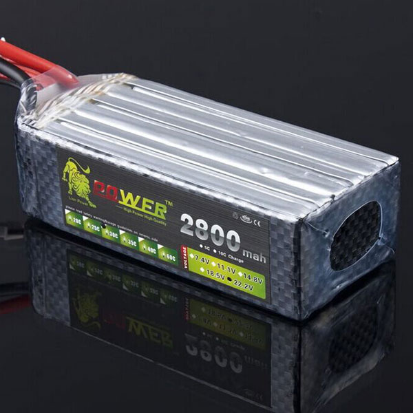

Description:
Product type: Rechargeable lithium polymer battery
Battery parameter: Lion Power 22.2V 2800Mah 30C
Battery capacity: 2800MAh
Continous discharge rate: 30C
Battery size: 11.7 * 3.7 * 4.3cm / 4.6 * 1.4 * 1.7in
Battery weight: 379g / 13.4oz
Note: due to the difference between the measurement, the battery dimension and weight may have little error.
Plug: T
Package weight: 403g / 14.3oz

If this weight is accurate it's the best weight to piwer ratio for 2600-2800 ma units I have seen.
I'm testing a single 5200 ma multi star today in a normal flight after a hover test to see how much past 16 min I can get taking video. I am concerned as an ATP pilot about adding 650 gs right under the main battery. This would be a reason to use two 2800 aux batteries mounted on the arms as you can position the for and aft for cg. I have these in order
