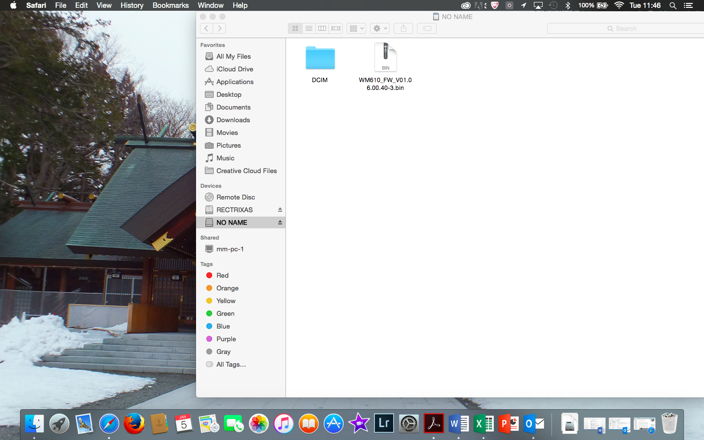

Just tried to upgrade to 1.6 on both my inspires, never had any issues before but both birds do not start the update process, and when i go to the app it still says i am on 1.5 anyone else having this issue just seems strange with both my birds
Post a picture of the SD card root directory with the FW on
