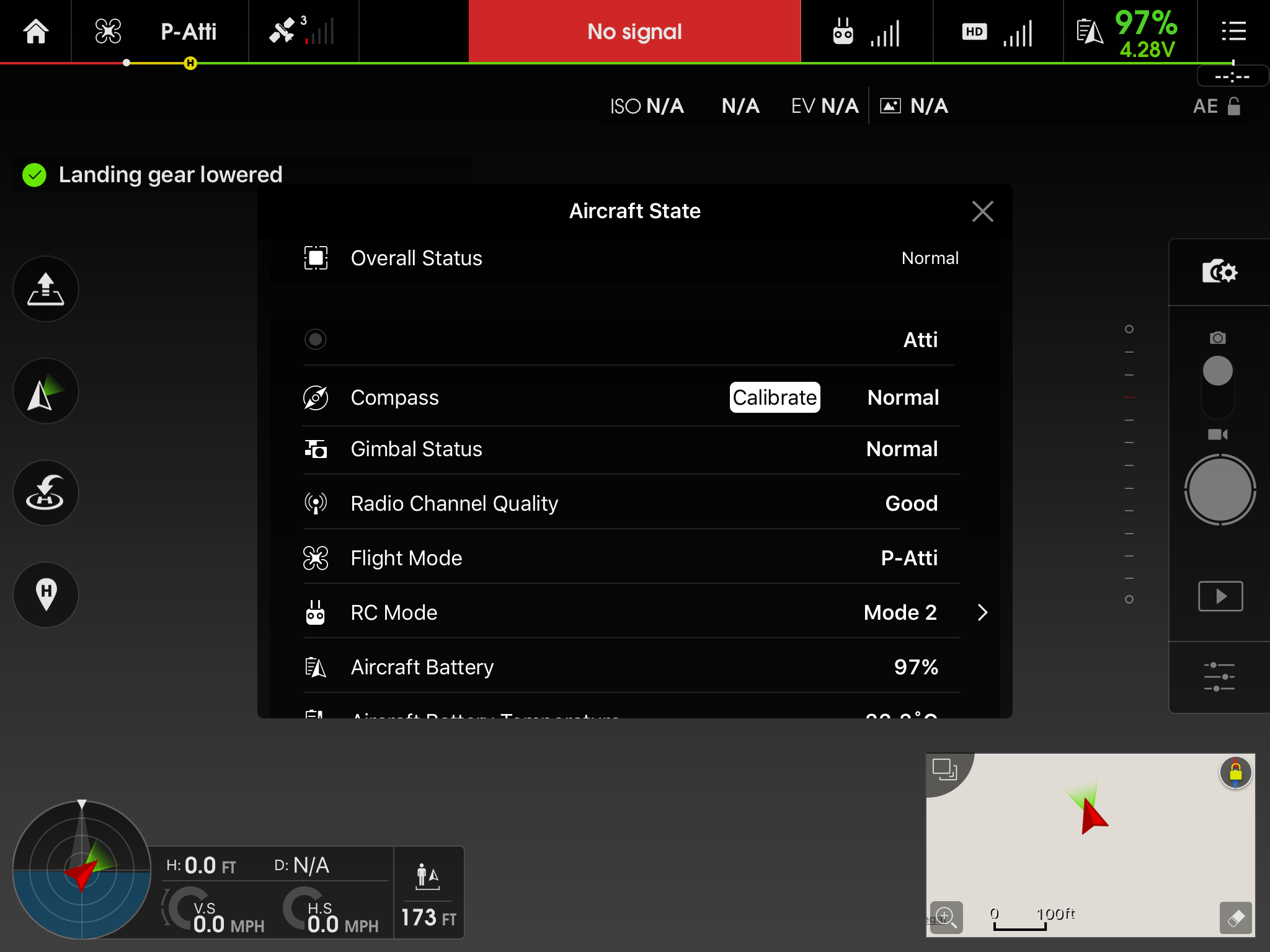

I had been flying with the self adaptive gear toggled off for a few flights as we were doing some low flying shots. Then I took off toggled it back on and now i haven't been able to get form Landing mode to travel mode.
Question what does your status screen show when the gimbal is not attached?
