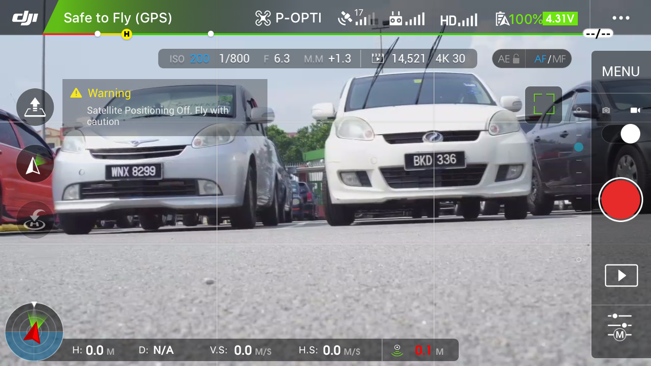

Updated to the latest firmware - Inspire 1 Pro Firmware v1.8.1.00 and here are some feedbacks:
1) As attached, I got this error, Stelitte Positioning Off, fly with caution error. Twice out of 4 flights this error came up before take off. Satellites was at 12 + . Anyone else getting this error on an i1 Pro?
2) Video Signal quality was low on both controllers (Pilot and Camera Operator) and RTH kicked in at less than 100m away from us
3) Automatic landing skids didn't open when hovering less than 1m from the ground. 3rd out of 4th flight
4) On my last flight, single operator, iPhone 6 was stuttering and 'Low Signal Quality' error. Wasted airtime hovering doing nothing figuring out what was wrong with the setup. Had to land at 50%, swap devices to an iPad Air 2 and continue flying.
Anyone else getting these errors on the new firmware? Thanks

Check your battery history for any logged errors - you may have a weak cell or they are not tracking within 200-300millivolts of each other
Reactions: Caleb and DamesNY
Thanks for the advice, is the battery history in the Go App or somewhere else? I have only had this error twice, both in the same geographical area too.
In the Go app on the battery page. Hit History and you can scroll down and see any logged errors. Also keep an eye on your individual cell voltages whilst flying.
