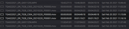

Here's a good example.
The I2, when recording to ProRes on SSD, gives you TC and datestamp that looks like this
If you look at the highlighted sequential files, P00001 comes right after P00000 with no gap... however, the MODIFIED date, which is the only starting point we have for dropping into a timeline as TOD, because the I2 gives us a 00:00:00:00 start time on every file... the MODIFIED DATE is NOT the actual time we started recording the file, as you can see... because if P00000 started at 11:15:06 and was :00:04:49:18 long, then P00001 would not have started recording at 11:16:16
What the editors have found, once again, is that even if I make sure my TOD is good on the Crystal Sky and I2, the I2 creates file times that don't seem to mean anything useful.
Those GX### files are GoPro files, which DO give you good TOD TimeCode... go figure.
Any thoughts?
It's a multicam shoot, so unless I slate every shot, my footage is headed for the b-roll bin unless I can get TOD to work properly.
