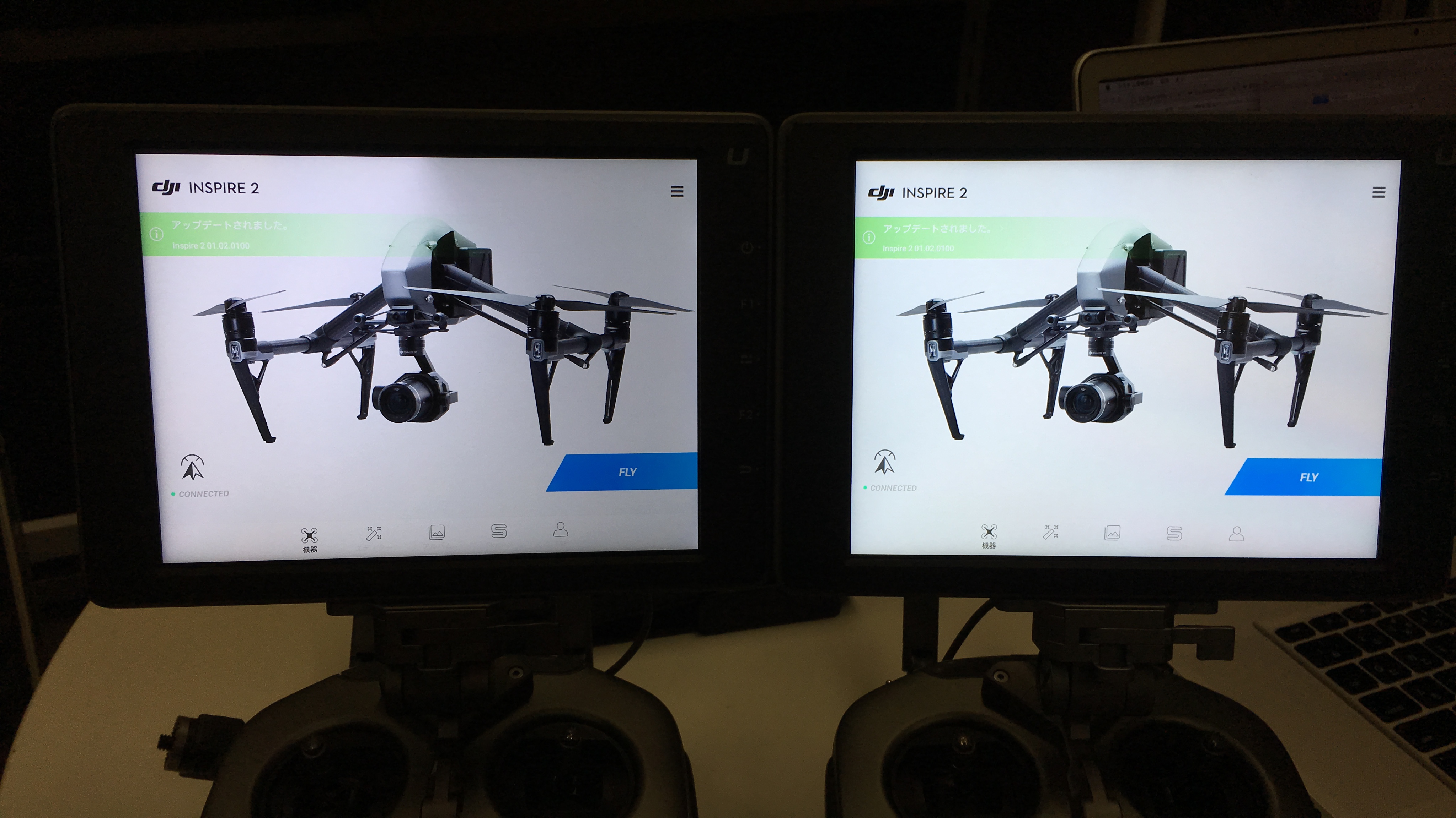

Thanks for sharing. Unbelievable. Weird, the red line appeared after a FW update??
Yes it did. I opened the box. Was fine on the old firmware. Upgrade to the new one and there it was. Most disappointing as I had high hopes with this new UB. Other than the red line it works but was only able to get two very brief flights with both the I1 and I2 on consecutive days. Strange weather we are having here for the past week or so.

We have two CSs and one suddenly lost quite a bit of brightness soon after we got it - and the right half is even darker, same as with Stan. The thing is we may need them for jobs so we are not sure of how long DJI takes to get things repaired.
My Ultra blacked out on me mid flight on my P4P. Luckily I had LOS and was able to land. I then had to remove the battery as the unit would not turn on. When it finally came back up the screen brightness no longer adjust and half the screen is darker than the other. Sigh!!!
My first failure happened in December 2017. It took over 2 months to get a replacement. I think they were just overwhelmed with a product that was not appropriately designed. It failed with this same portion of the screen turning gray within 2 flights. I just decided to use it until June when CrystalSky Monitor ultra units became available for immediate sale by the vendors. Then I sent it in and I received the repaired/refurbished unit within two weeks and it has been working correctly since that time.
