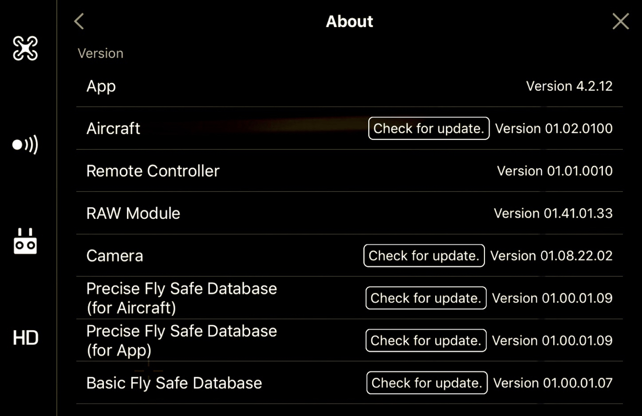

This is what I show as current as of April 22, 2018:
I did do a uninstall of the RC, rollback, and reinstall of the 1.01.0010 version using GO's opening screen "hamburgers" which fixed the RC charging issue, but does this mean I also need to refresh via Assistant 2 (ver. 1.2.0 -- if it works!) of the aircraft again?
@Casey53 Here are my version numbers as of 2018-04-18 (Wed) evening. The numbers are identical to yours, but the system exhibits the two known issues below. If your system, with identical version numbers, no longer exhibits one or both issues, then we know DJI is releasing new firmware under identical version numbers, which is TOTALLY F*CKED UP.

#1 was cured when I rolled back to 1.0.0002 and then updated to 1.01.0010 again. Just plugged RC into charger now and the four LEDs are working as they should.
Don't know about #2. I just refreshed the aircraft firmware via Assistant 2 again (First time was via the iPad Pro.) and it seemed to go faster using Assistant 2 also. Did another VPS cal. too. I will do the IMU and Compass later after it cools down a bit. Might fix the looking left matter maybe, but I never use the RTH feature as I manually fly it back and land it myself most of the time.
